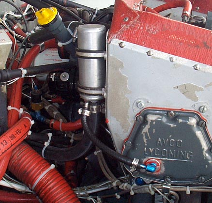

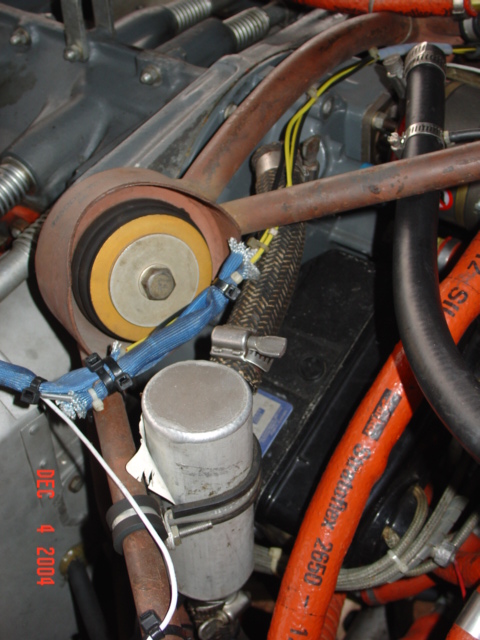

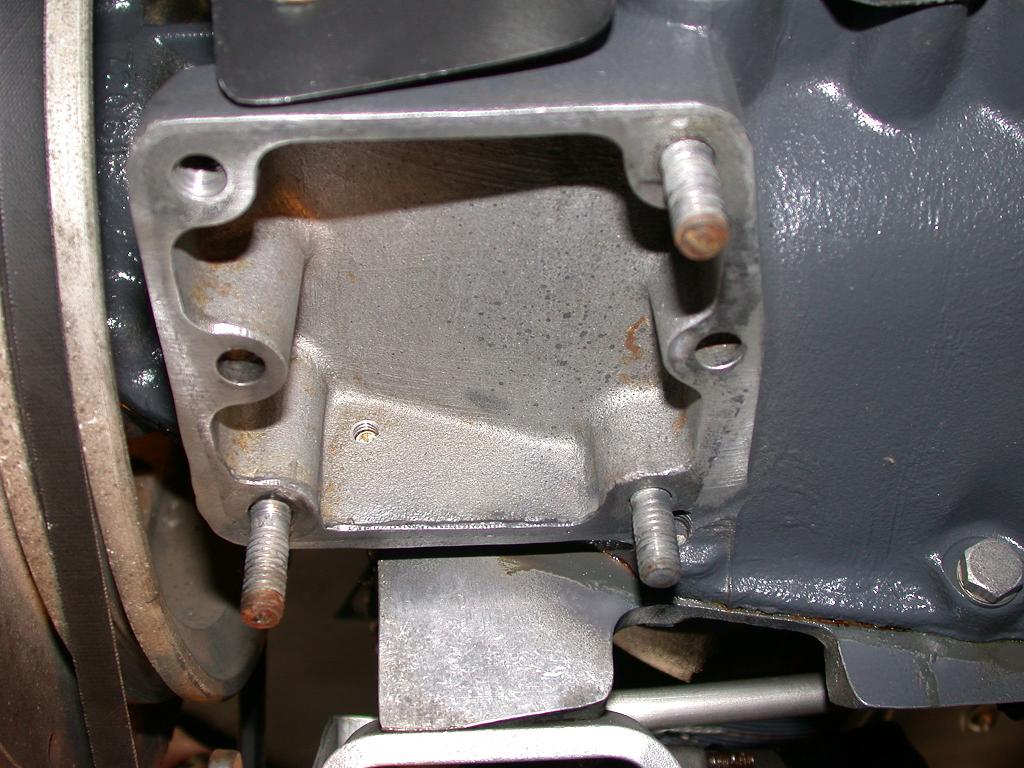

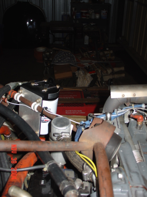

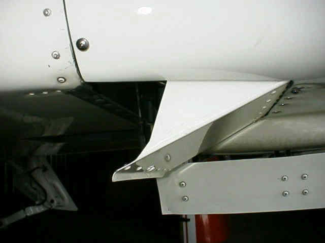

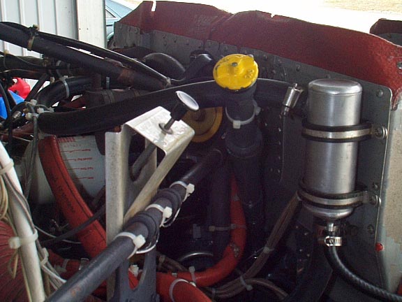

  • Air / oil separator, all model - submitted by Bob Tippens (112TC), additional photos by Bill Bailey (112)
M20 installed/mounted on motor mount, pilots side.
Pictures from Taz.
Data from Wag Aero Catalog.
Air Oil Separator
FAA/PMA'd M-20 Air/Oil Separator, Model 300
SKU: I-287-000
Price: $360.00
FAA/PMA'd M-20 Air/Oil Separator, Model 300 The Model 300 Separator is the only one of its kind to be Stc'd for all aircraft engines up to 315 hp. The Model 300 series is now 5 STC'd for engine sizes up to 315 hp and is also appropriate for Experimentals. No mounting brackets are needed. It mounts in the breather line with simple clamps. For use with dry vacuum pumps only. Both Code 4
SKU/Item#: I-287-000
Price: $360.00
A reeeeeeeeeally clean belly.
Oil loss/consumption improved/stopped from 3.5 flying hours per quart to 7. Always keep 7 on the stick.

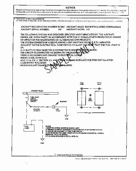

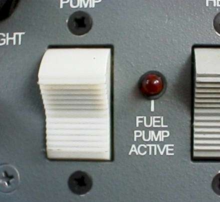

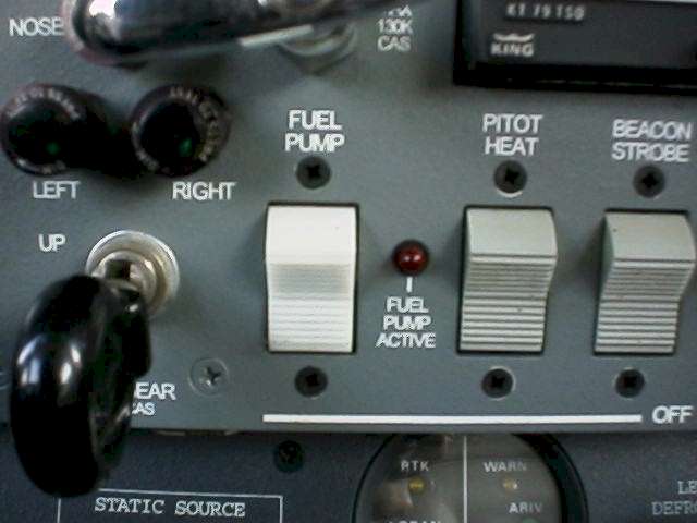

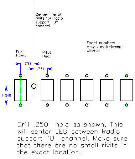

  • Electric Fuel Pump LED Indicator, all - submitted by Sven Faret
Ever leave the fuel pump on? We all have! I HATE when that happens, especially when you consider $1000 for a new one.
This LED blinks at you until you shut it off. I never leave it on more than necessary any more. I have FAA approval for the install with schematic & parts list for anyone interested.
top

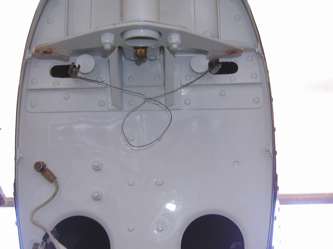

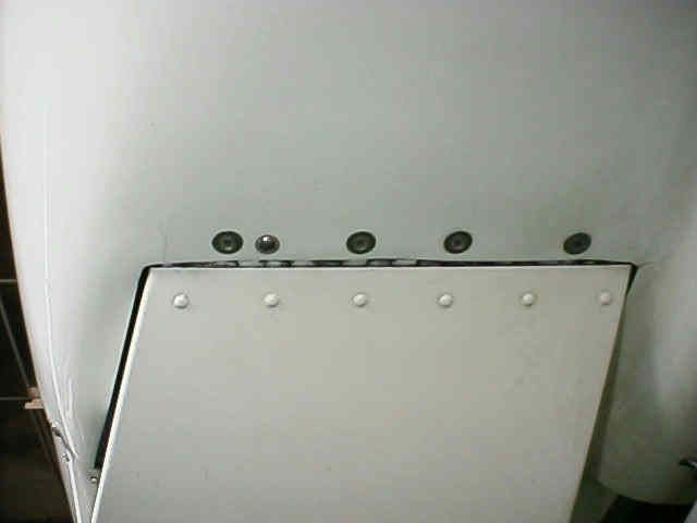

  • Fuel leak from fuselage vent/drain, 114 models - submitted by Sam Butler
If you notice a flow fuel drip from below the fuel selector and fuel position handle position has no effect, the problem may be the vent in the tank. This is designed to be an emergency vent for fuel injected aircraft (keeps the wing from collapsing) and has no connection to the selector valve. There is a very simple check valve at the top of the tank (a ball and socket type). Very difficult to replace. You can determine which is leaking by only filling one tank. It will continue to drip until the fuel get below the valve. Solution, fill to the tabs unless going on a trip.

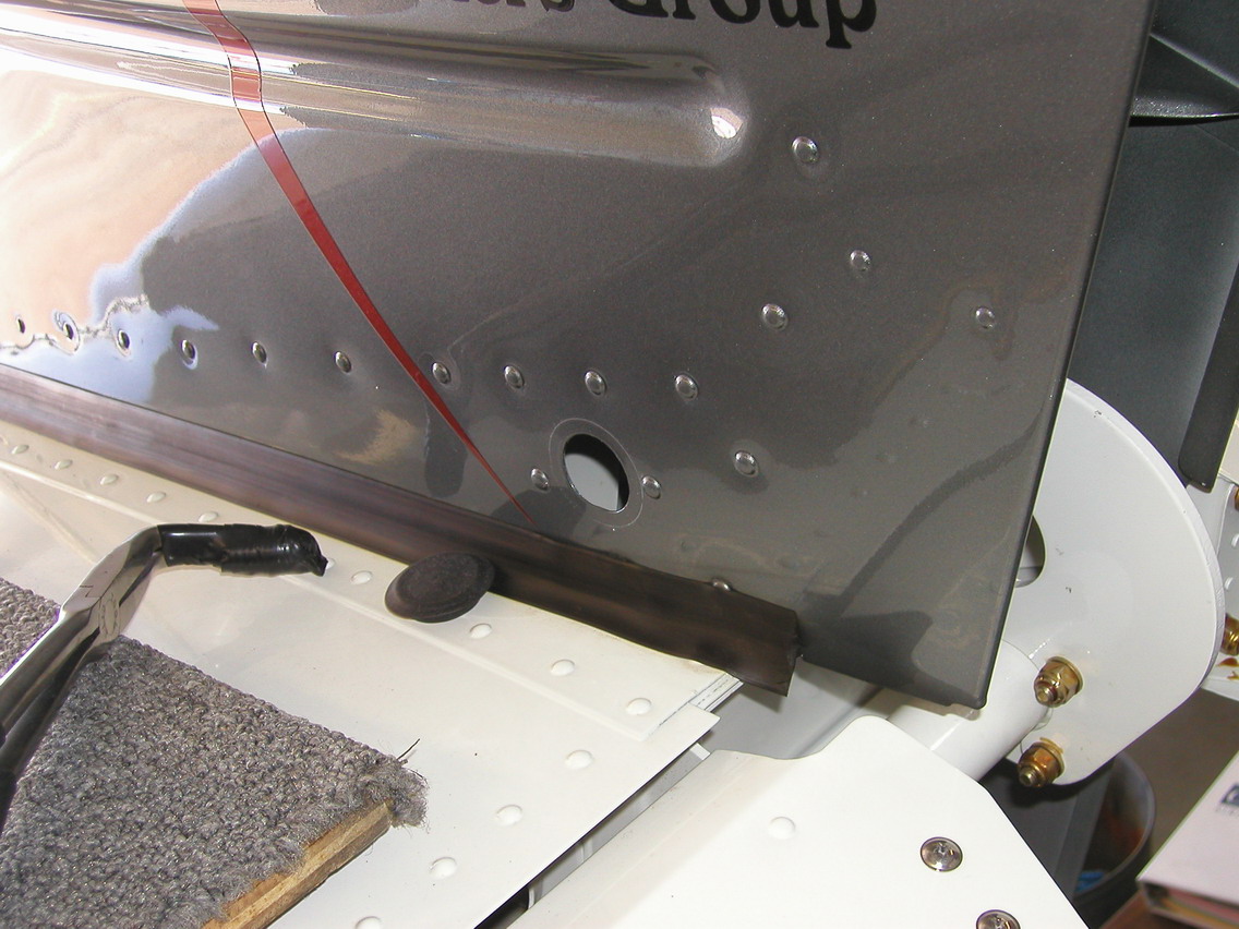

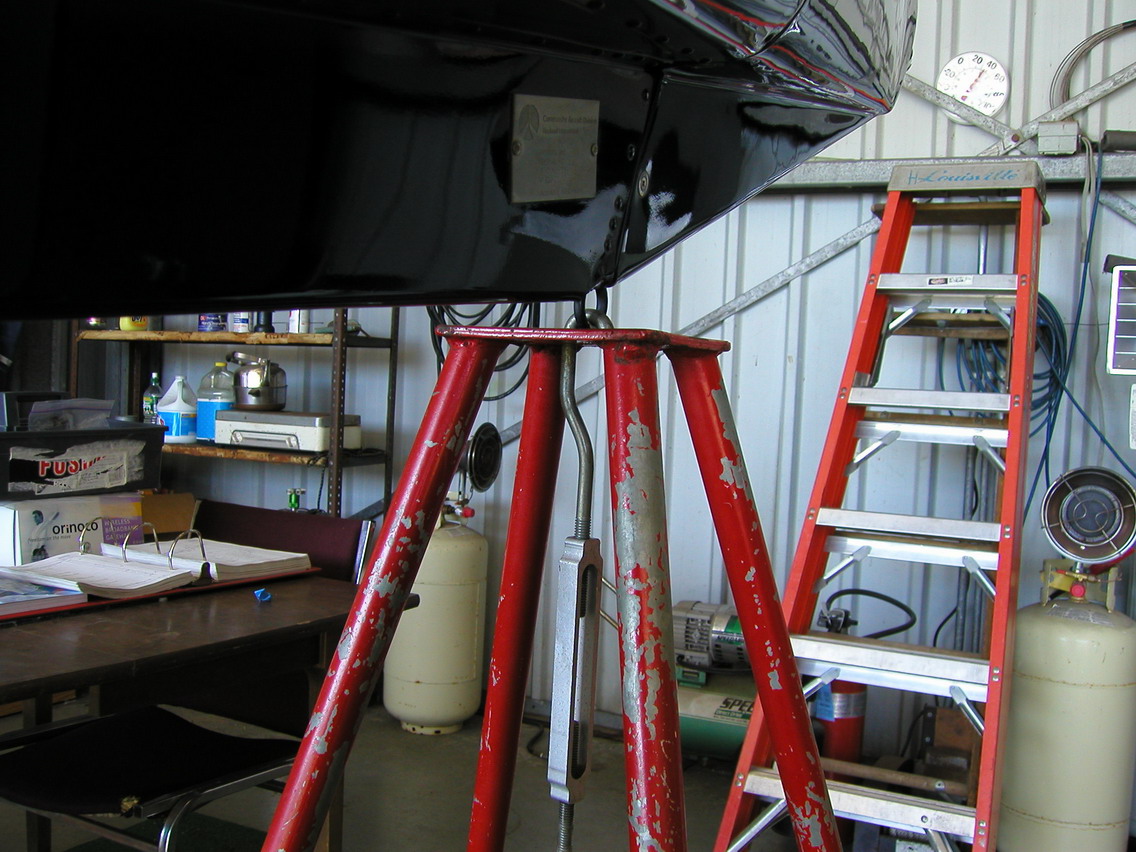

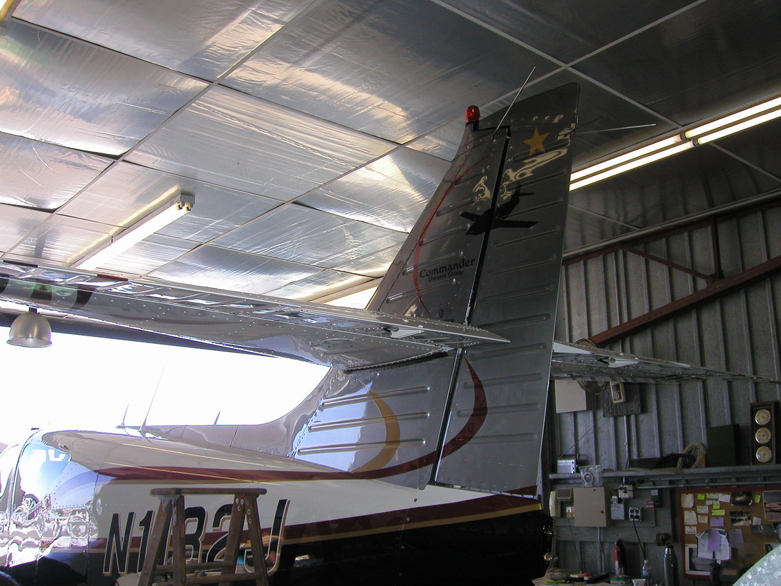

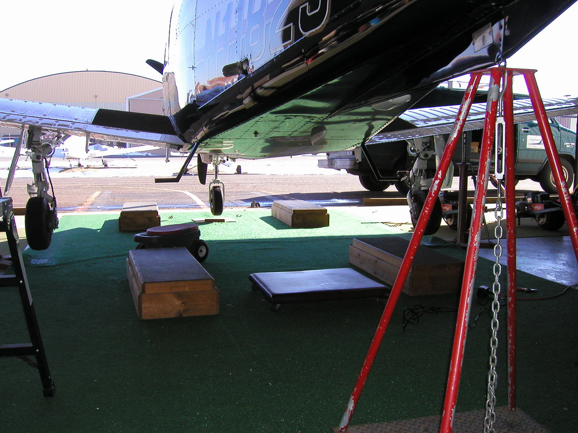

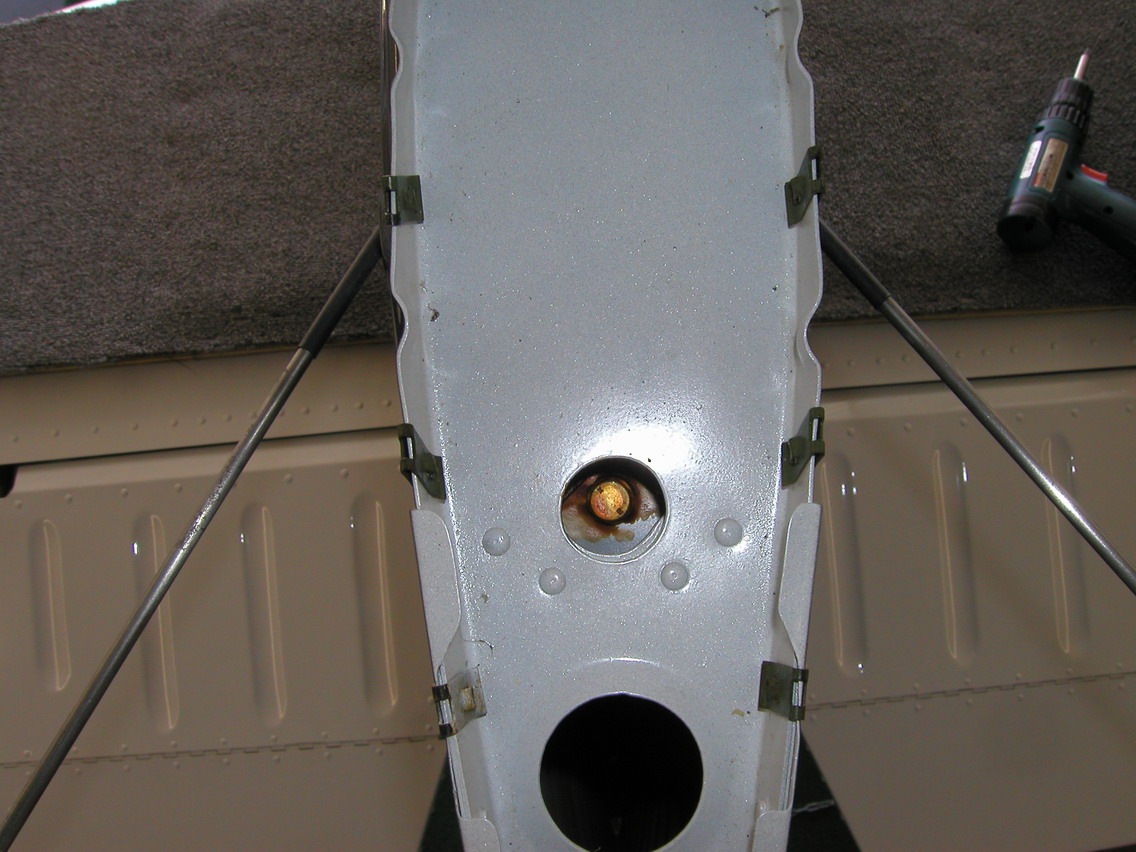

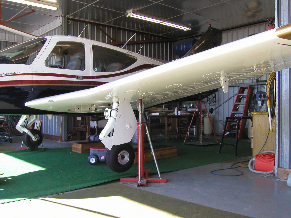

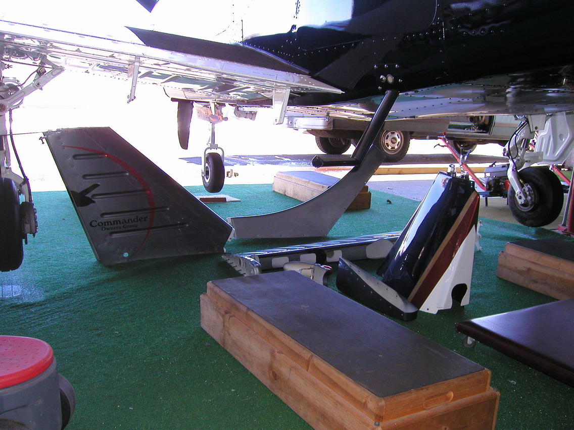

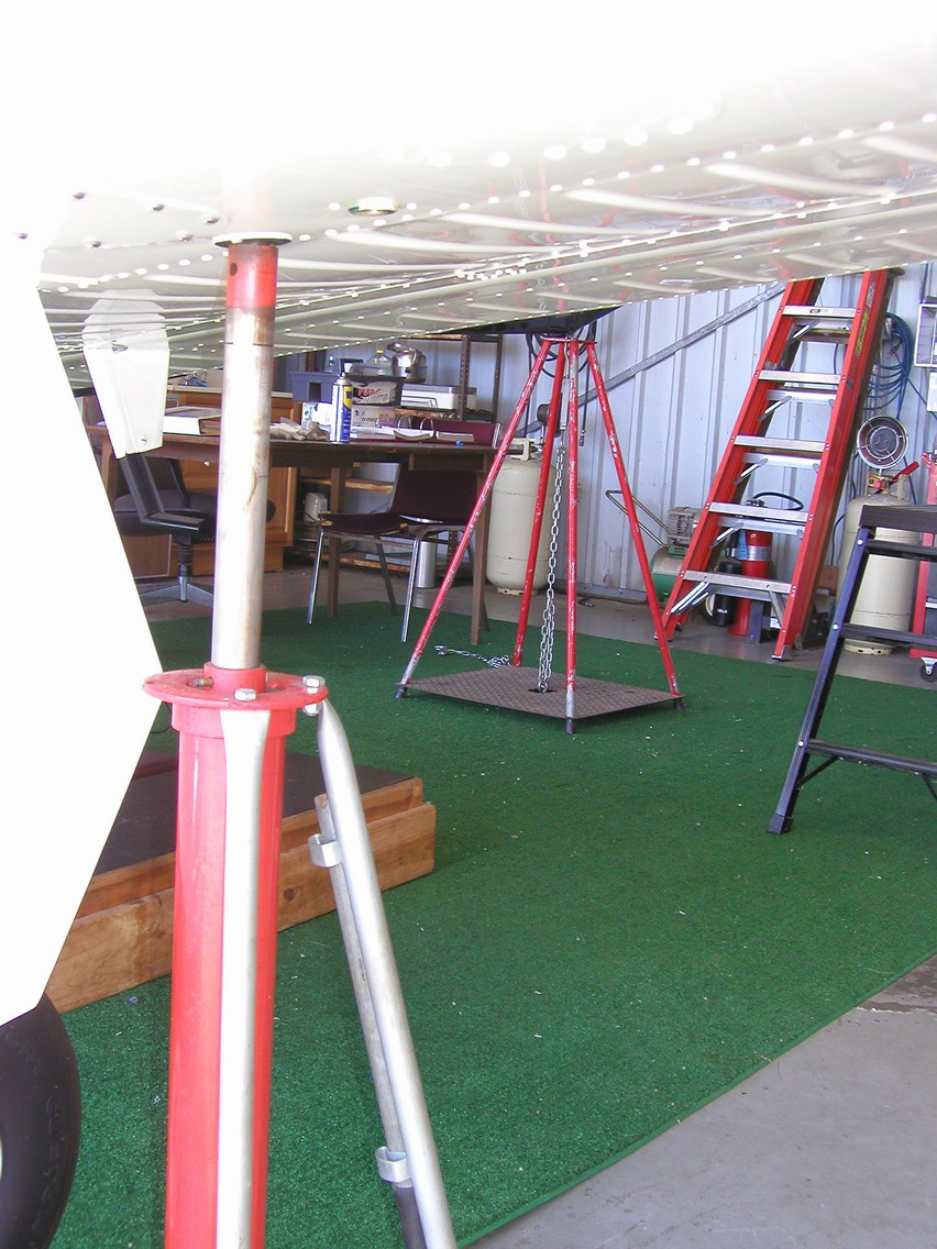

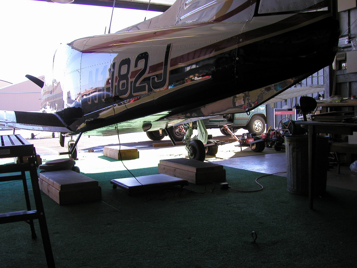

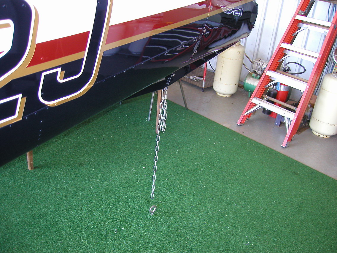

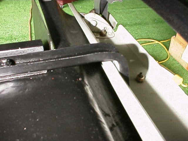

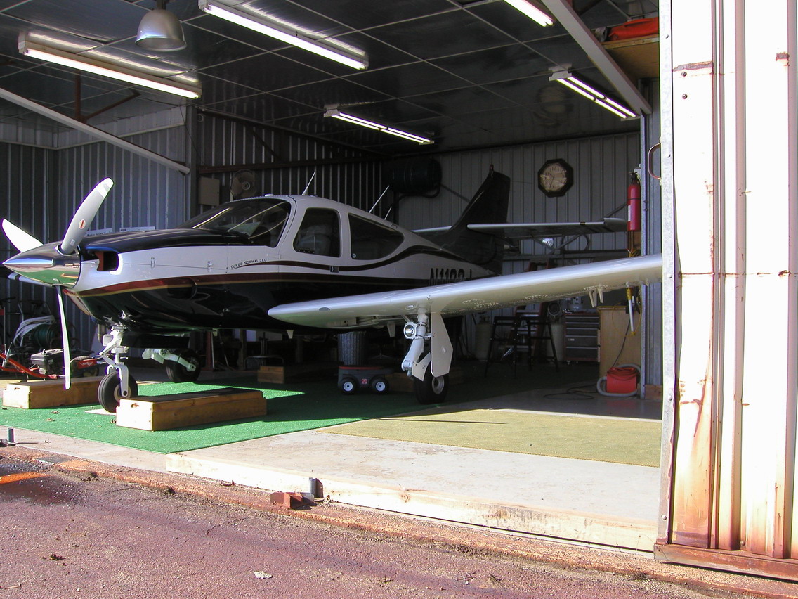

  • Fuel leak from wing seals, how to find. All models - submitted by Sam Butler (8/06)
As the owner of three commanders, I have become an expert in sealing the tanks. If your leak is near or along the area of the fuel pickup line, it will show itself at the access panel near the jack point. Also you will see some blue in the wheel well.
Take this plate off (it is an inspection plate not sealed) and clean this area and the fuel lines good with soap and water. After it is dry, use baby power to coat the area. use lots of powder.

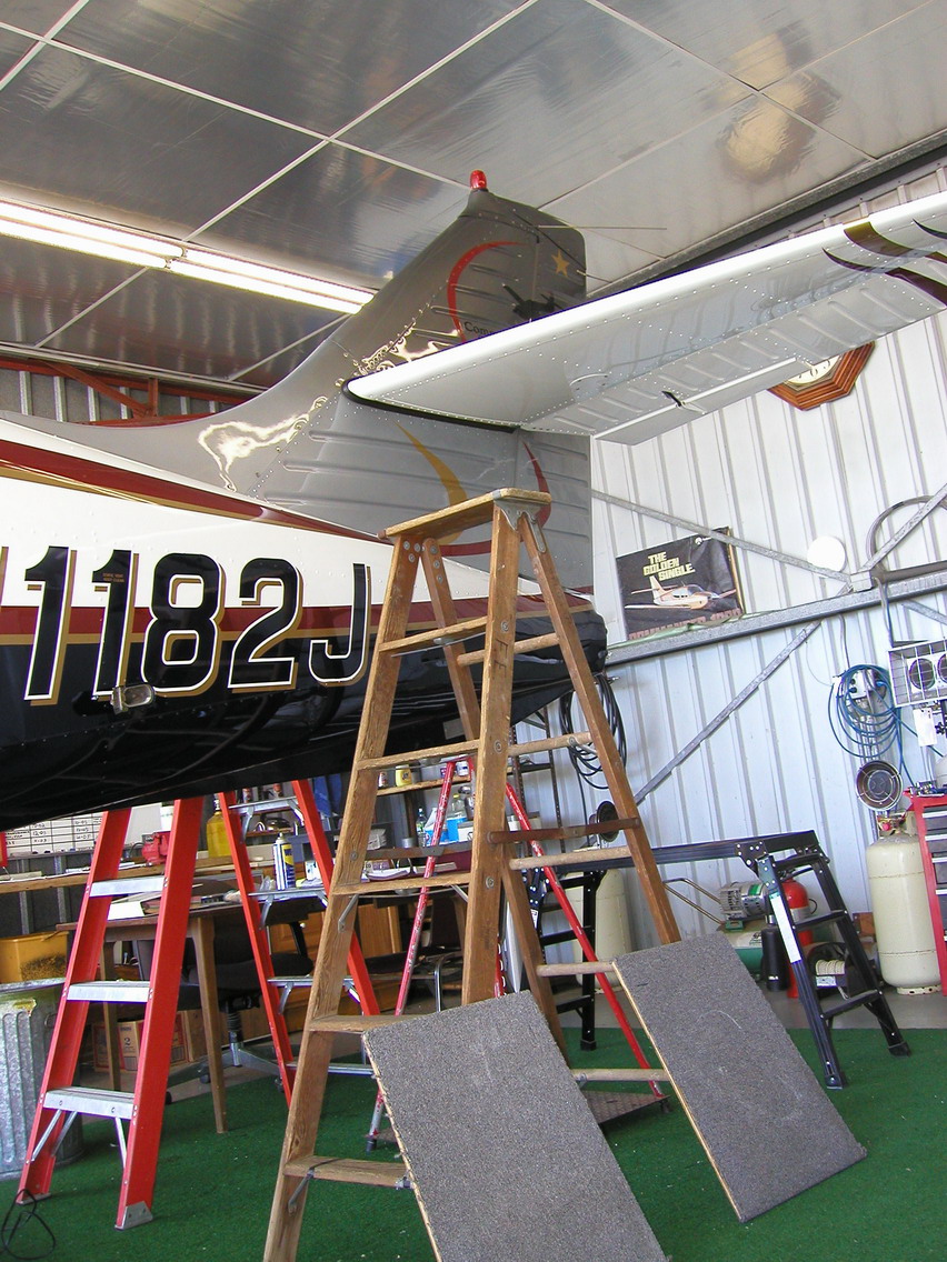

Put the fuel selector value in both and jack up the other side of the plane. Keep checking on the powder as the tank fills. Use a mirror and You should see your leak.
You can do this several time by moving the jack from side to side.

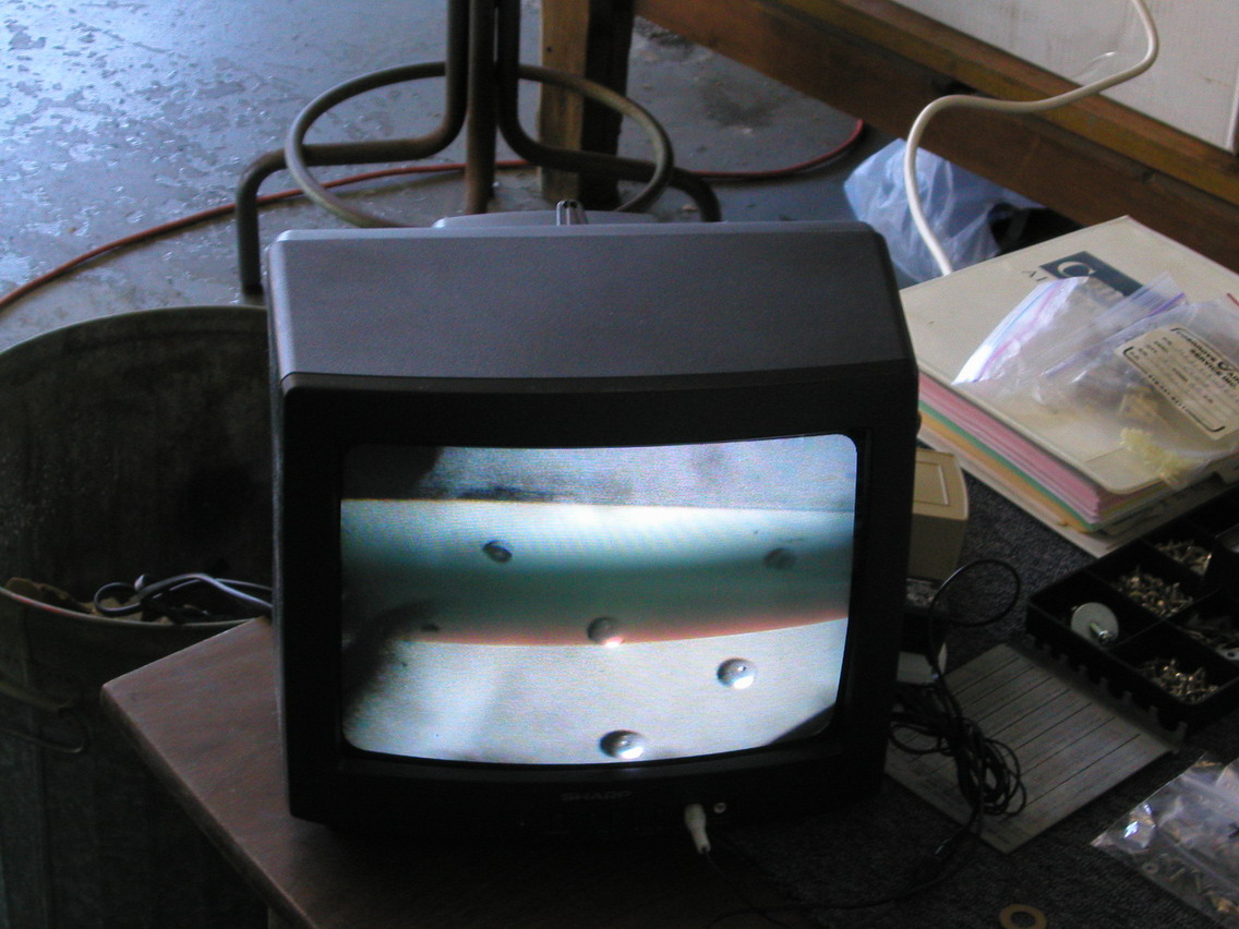

  • Fuel Tank Resealing - submitted by Mark Standrich (7/09)
This is tough to nail down but it averages about 4 hrs labor per inspection panel
Remove the panel, clean the sealer off the panel and around the inspection hole, back coat the domes of the nutplates, and reseal the panel.
If any nut plates need to be replaced due to leaking (commonly caused by too long of a screw installed) additional time is required.
Leaking rivet lines can be hard to estimate till you open it up and see what's happening
inside. Sealer removal is slow and tedious work with Lexan scrapers and Scotchbrite, vacuuming the debris and wiping down with MEK followed by a good going over with a painters tack rag.
I recommend the resealing of the rivet lines first and allow that sealer to set before
closing any panels. TIP++ keep the remainder of the sealant batch used in a cup
so you can verify that it set up properly ...
Care need to be taken to not get any sealer on the fuel level floats on the transmitters.
Rivets that need to be replaced need to be shot in wet ( with sealer) and i like to give a tank a full 24 hrs to cure before replacing the fuel. Flush the tanks till you get all the fines out of the sump drains.
CS3204 B 1/2 is the standard used which can be acquired thru Aviall and many other sources.
Just a note that the sealer sets up quicker with warmer temps and slower with cooler ones
Skinny long arms are a plus for this job and ventilate the tanks well before commencing the work due to the explosive nature of 100ll vapor!!!!!

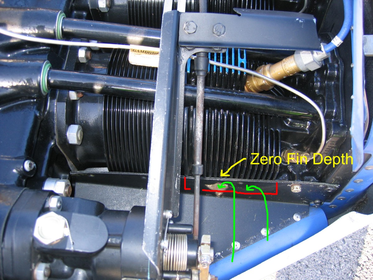

  • Hot #2 cylinder, 114 - submitted by David Tubby (11/08)
(CHT was reported by user at 425F at 70* ROP) The problem with #2 is that the fins at the front of the cylinder have no depth at all. The baffle in its default location sits tight against the cylinder and so no air passes down the front of the cylinder to cool it. The fix is to create a gap of at least 1cm. We did this by putting 4 washers on each of the bolts between the cylinder and the baffle on the right side of the cylinder as you look at it. This pushed the baffle away from the cylinder and creating the necessary gap.

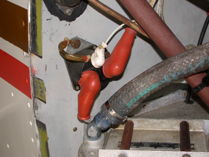

  • Master Relay testing, all models - submitted by Bill Bailey
It is possible that your relay is OK and your master switch internal contacts are grubby. Either circumstance can create the symptom you are describing. If you have time and are inclined:
  1. Shorting the appropriate coil contact to ground repeatedly (particularly the first try of the day after the plane has been sitting) and checking for the solenoid "slap" will help verify the relay coil is firing.
  2. Checking the resistance across the relay power contacts. Relay cable terminals work fine for this test... clip your meter leads to the terminals w/ the cable leading to the buss disconnected and watch the resistance values across the terminals while repeatedly activating the coil. It the power contacts are burned or dirty, the resistance may vary widely. A difference of more than 0.1 - 0.2 Ohms indicates a junk relay. (And the absolute value should be much less than 0.2 Ohms. Any significant resistance across the power contacts will absolutely squash the amount of power available to the ship's buss. Just 0.2 Ohms resistance in a 12V system will cut the available power by by nearly 50%.) Note: you should use a quality digital meter for checking the resistance values.
  3. Check the resistance across the master switch contacts as in # 2. Allowing the coil to reach ground (the switch's function in life) isn't as fussy or critical as allowing power to reach the aircraft buss, however, if the switch contacts are gummed up w/ carbon, dirt and grime, there may not be a good enough ground to permit the coil to reliably fire when you rock the switch shut. Check several closures.
    Barring a broken wire or funky ring terminal connection, you should find the culprit w/ the checks above. Don't rule out loose or marginal terminal connections either. Much of the wiring in these planes is well past it's prime and loose or broken connections cause many, many problems. Look at all the alternator & gear problems on the Board that end up being wiring issues.
A final thought is that given the cost of $13 - $30 for a relay, why not change it every three to five years when you change your battery? It's a key part of the aircraft electrical system critical path analysis. Think about what we spend changing pneumatic system filter elements each year or the ELT battery change every two years. Pretty cheap insurance.

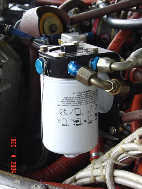

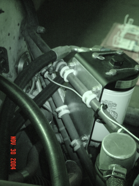

  • Remote oil filter installation, 112 models - submitted by Bob Tippens
ADC Remote Oil Filter Installation on the Motor Mount rather than Fire Wall. Pictures from Taz. Installed for over a year and makes for a very clean remove/install process. Data from Wag Aero Catalog.
Remote Spin-On Filter for All Lycoming 0-320 & up by ADC
SKU: I-963-003
Price: $475.00
FAA/PMA'd. Lycoming 0-320 series & up w/standard screen housing. Adapter kit has a larger mounting bracket which allows the weight to be distributed more evenly on firewall. When removing tight spin-ons the anti-torque feature allows removal without damaging the firewall. Uses Champion CH48108 or CH48109 filters. Kit includes STC, hardware, hoses, fittings, engine adapter and installation instructions. Please specify aircraft make, model, serial number and "N" number. Shipped FOB factory. Code 4
SKU/Item#: I-963-003
Price: $475.00

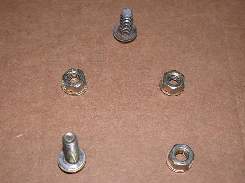

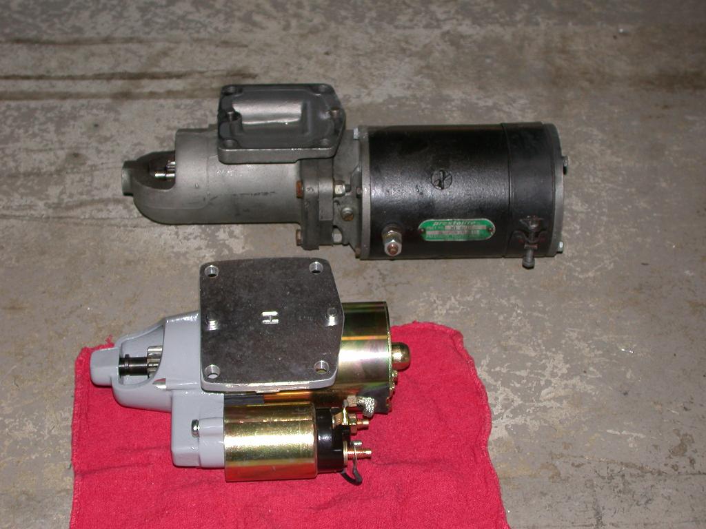

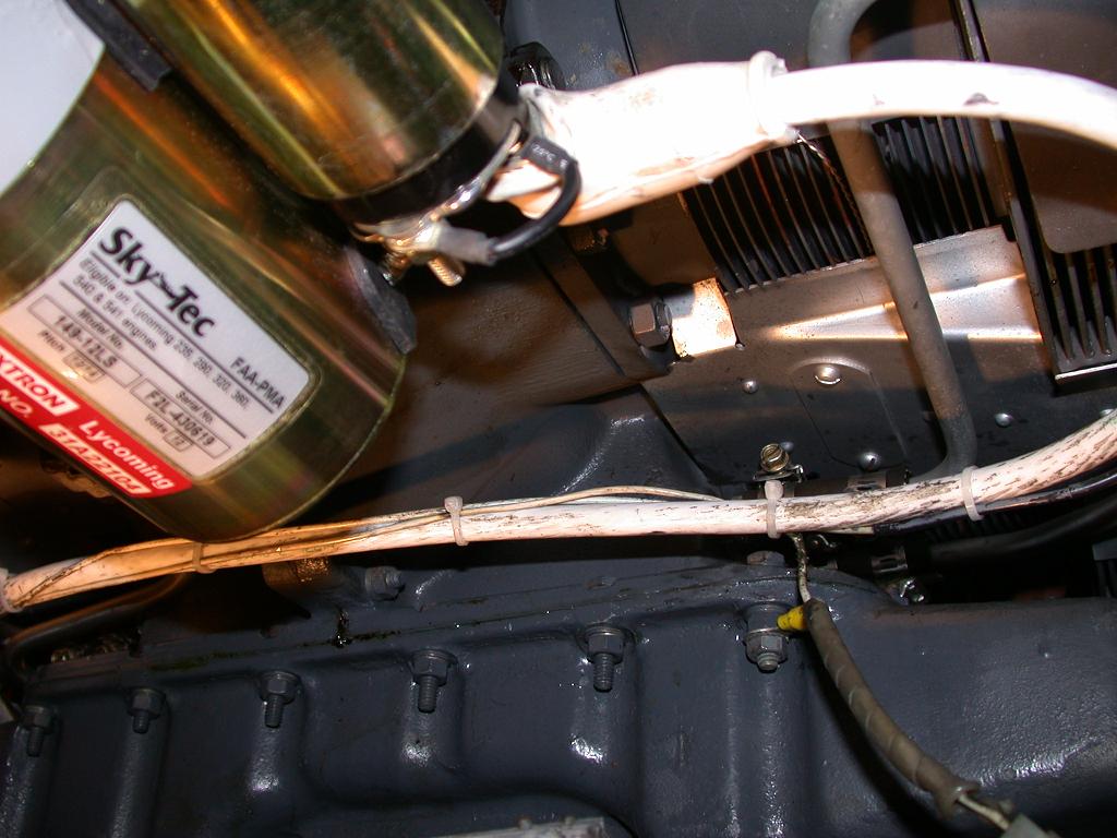

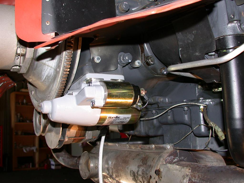

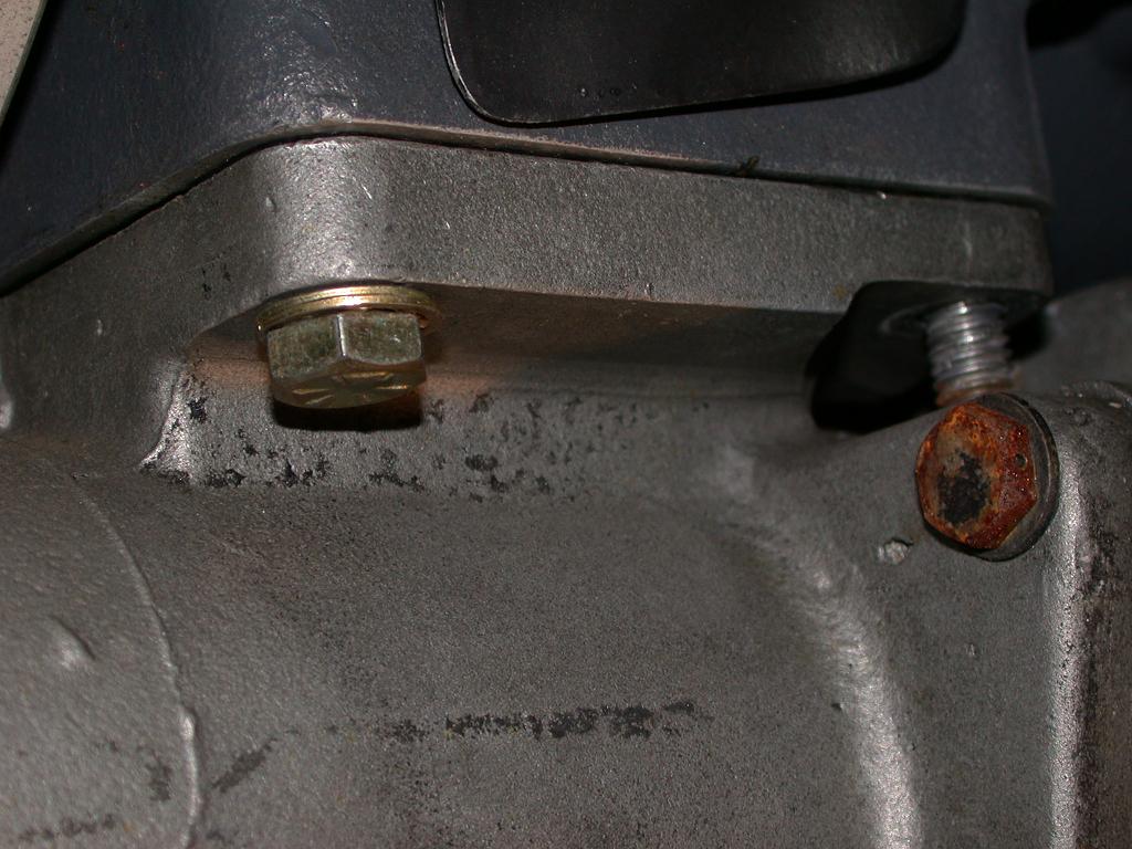

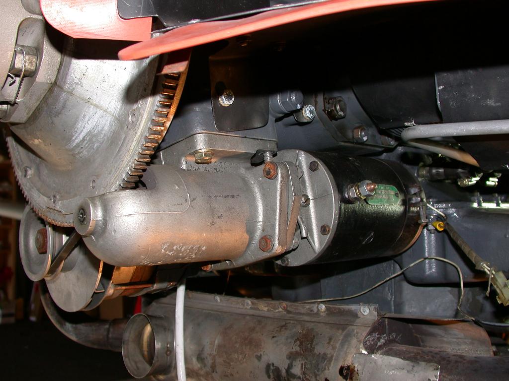

  • Skytec lightweight starter installation, 112 models - submitted by Dave Kalbach (12/06)
Definitely spins the prop faster and makes hot starts a breeze.
SKU:
Price: Approx $400
Old starter - lead gets removed
Bracket comes off
Mounting bolts
Starter solenoid
On firewall here but location may vary depending on your serial number
Old and new
Note that new starter requires slightly more lead length
Mounting pad with starter off
A good time to clean up that area if needed
Washers

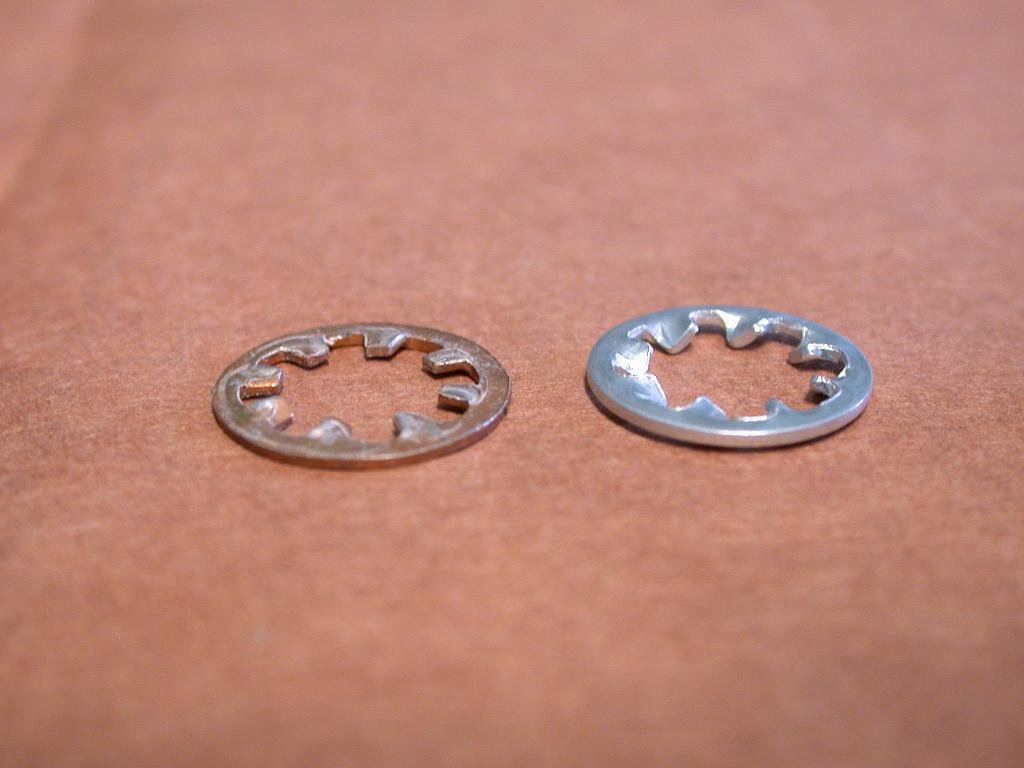

The starter ships with new washers. FAA mandates that these star washers can not be used twice.
New starter on
Leads reattached
Note regarding the Bogert large gauge cables;  I had heard of something referenced as starter drag. After replacing my starter I learned what it was. The new starter uses a solenoid instead of a throw out bearing to engage the bendix. I believe this combination causes excessive draw on initial start up. The result is the starter turns the prop one half rotation and stops. A simple off and on again with the key and it fires right up (the bendix is already engaged.) The Bogert cables are much larger (2 gauge) and have very little amperage loss over distance. This gives you more starting power and should alleviate the problem.

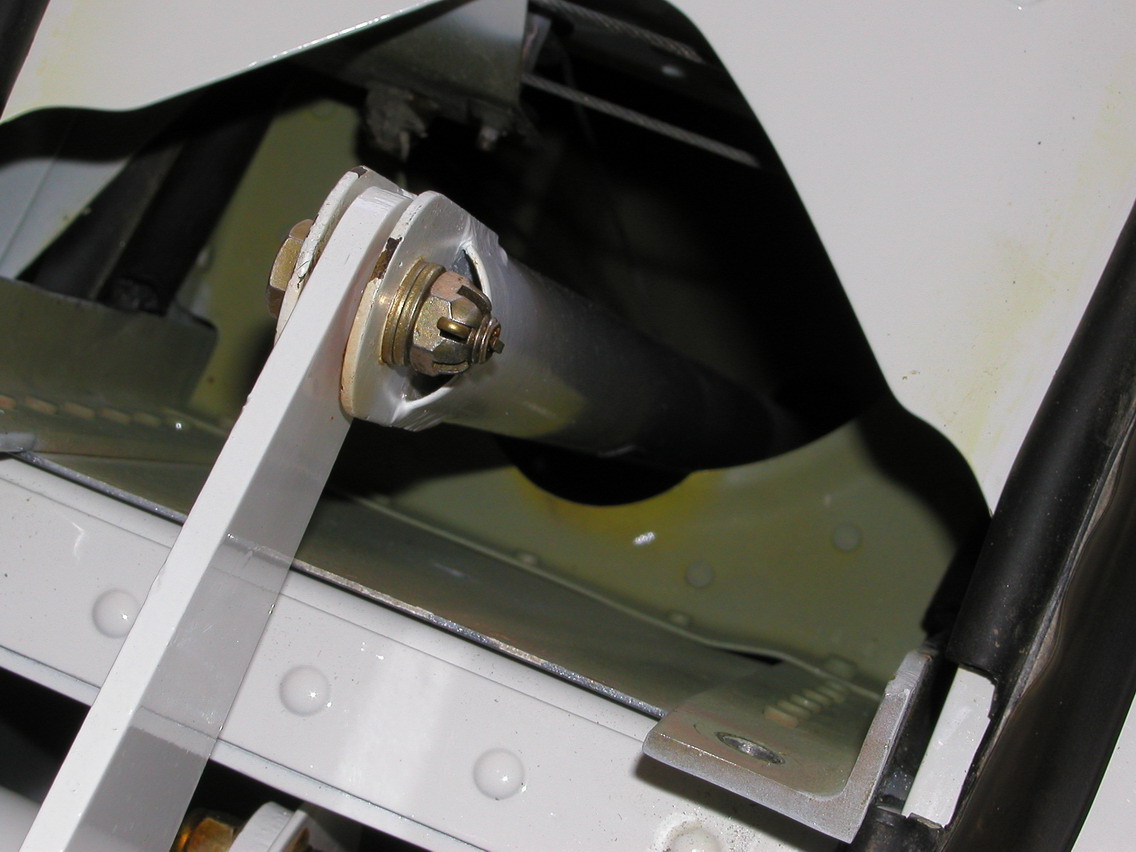

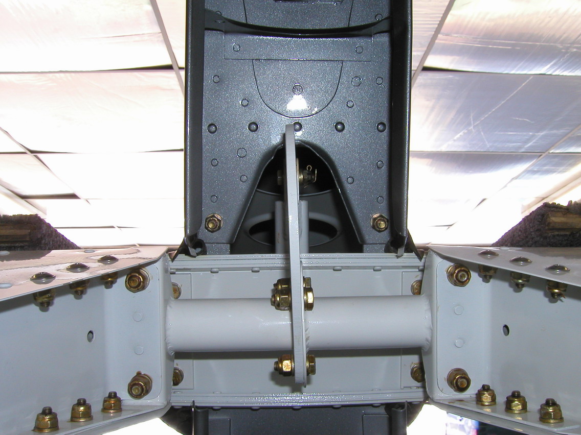

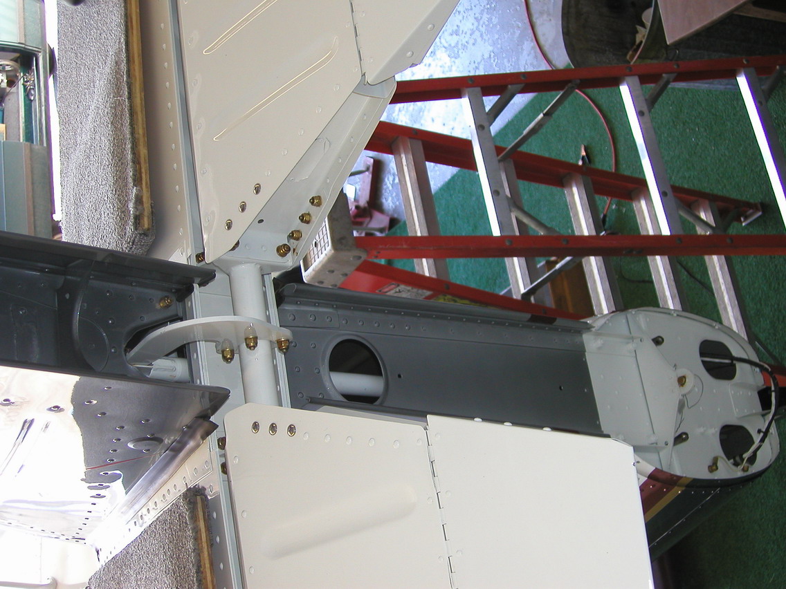

  • Brake pressure temporary loss, all models - submitted by Bob Tippens (1/06)
Problem - upon landing little brake effectiveness. Pumping up brakes usually restores normal operation until next flight when symptoms repeat.
The main gear brake calipers are being compressed during main gear retraction because the brake caliper "bleed screw" makes contact with wing walk support in main gear wheel well causing the caliper to be compressed resulting in little to no toe brake stopping effectiveness upon landing. After pumping the brakes upon landing the brakes remain effective/pumped up until the next take-off and main gear retraction at which time the same sequence of events occur. The evidence of this occurrence came be seen inside the wheel well where the brake bleed screw leaves marks close to the edge of the wing walk support in one or both of the wheel wells. The bleed screw contact point on the support is close to the installed elevated square bumper pad that is aligned with the round rubber stopper installed on the back side of the main gears.
Given that all brake components have been serviced and are working as designed, the
attached 337 and Commander DER documentation and drawing represent a fix for the described problem. A "Slot" must be created in the wing walk support within each main gear wheel well which will create a pass through space for each brake bleed screw rather than it making contact with the support followed by compression of the brake calipers.

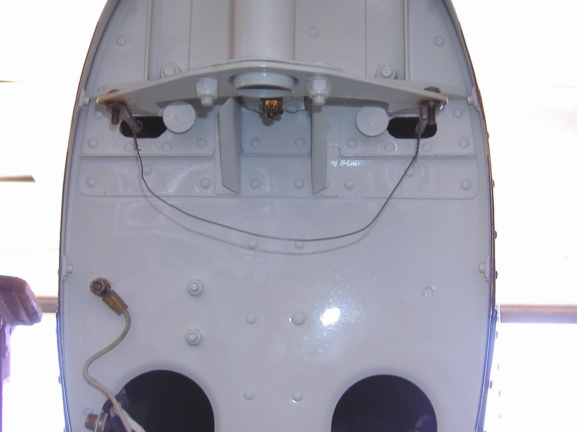

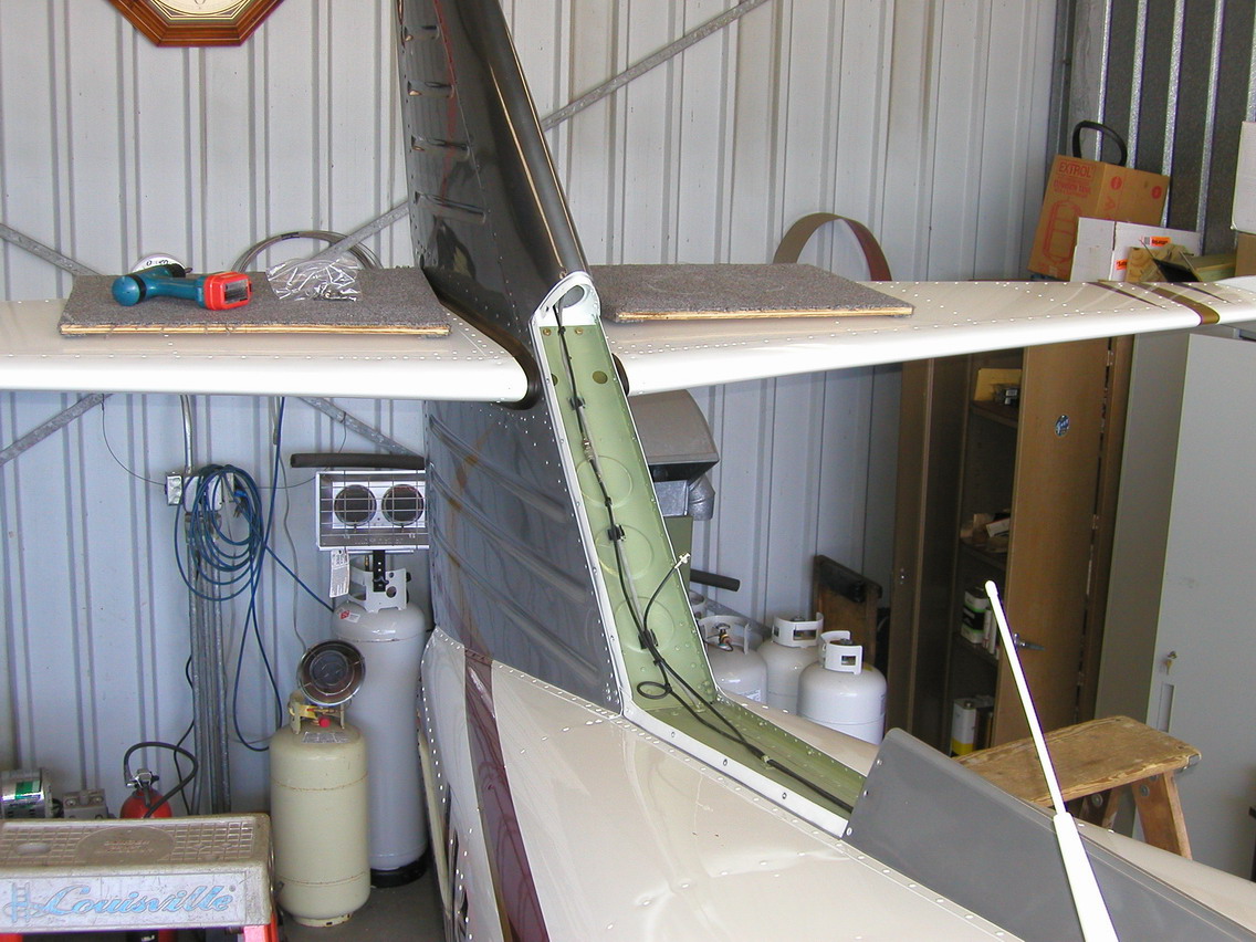

  • Strobe Power Supplies, eliminating noise - submitted by Neal Dilman
You can get rid of strobe noise by using a "ferrite choke" on the + going to each strobe power supply. Alternatively, you can use "the eliminator" (Lonestar Aviation) or a similar product for the same purpose. Unless its the strobe light itself...
and from Jeffrey A Boccaccio
As 08J goes back together with a re finished panel I am trying to take care of all the little irritants that bother me. One in particular is the cross modulation I was getting from my strobes.
I found the problem that I am sure other Commanders also have. The noise is being developed from a relatively high resistance on the supply cable supplying the buss for all the switches from strobe to landing lights and master radio. This large cable is screwed into the buss with a #8 Philip's head. Under normal conditions this would work OK, however, because the cable is so long and heavy its mass just moves the cable by movement. Very easy to test when you get to it. Just hold it and move it a little bit. The eyelet should not rotate. It was this connection that cause the noise. I replaced this screw with a self-locking #8 3/8's socket. Now you can get in there and really torque it up to a solid lock. Completely stopped all the noise and whatever else it might have been causing. Easy to see if you remove whatever you have in the bottom tray of your stack.

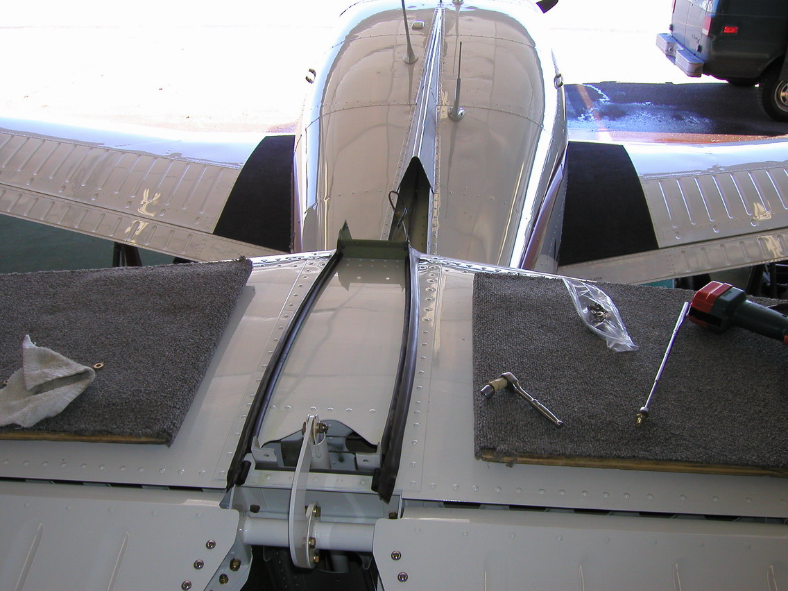

  • How to remove front seats - submitted by Sven Faret
Tie wrap the seat lock handle fully opened or the locking pins will cause you grief. Remove the 2 rear seat rail stop pins. Also slide the seat rear wards to get the pin lock supports aligned with the seat rail notches, lift up the rear and out it comes. (sort of)
Now the hard part. The seat rollers are full of grease, the carpet and door trim will get in the way and beat up, the consol will be in the way too. Best is to put a wide piece of aluminum between the rollers and the carpet. If the carpet was cut too tight to the track end then roller tangle will occur.
Now that you have paid some one 1/2+ hour to ruin several interior items it's ready for them to smash the hump under the seat.
It seems that all commanders have the fuel line cover (under the seat) destroyed by some radio man at some point having the small of his back resting on it. It was never meant to hold 200 lbs of man with his legs up in the air trying to get out. Make a shelf for him to sit and work on to save the plane from hidden damage.
If you care for your plane don't discount any of this.

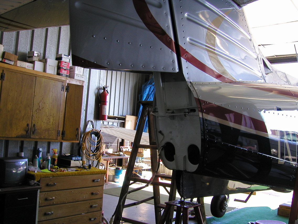

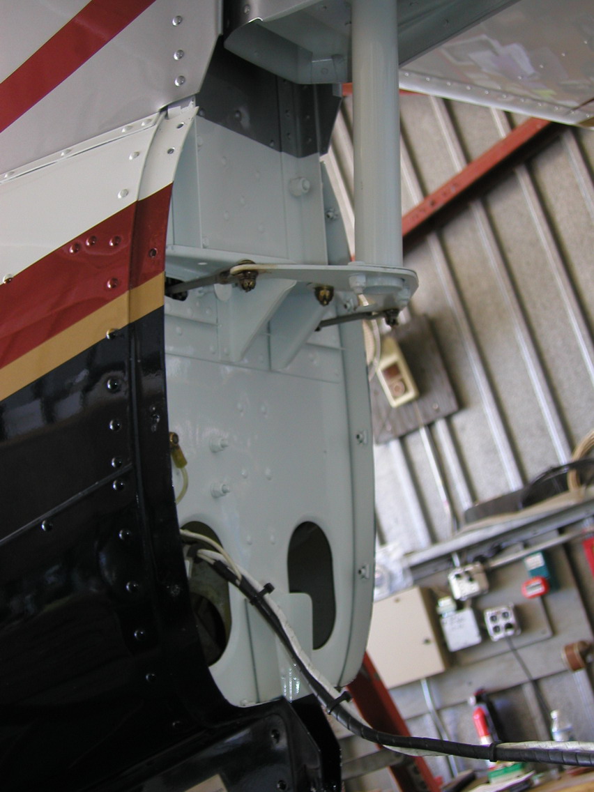

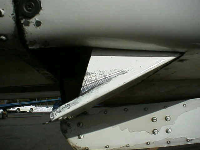

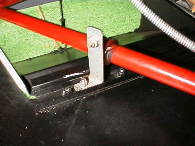

  • 112 cowl flaps, correcting deformation - submitted by Sven Faret
Original cowl flap doors
I've seen dozens of Commanders with cowl flpa doors that look like this. It's rare to see a plane in this situation without severe cracking and repairs around the cowl flap hinge area.
New look
They should look like this
Bracket
The problem comes from distortion of the cowling during flight. I'm sure many pilots wonder why they can't retract the cowl flaps 100% after the get the airspeed over 80 kts. Only to find that the instrument panel wants to deflect before the cowl flap control is fully closed. The wear point in the upper picture is where it stops.
Bracket Support
These photos show a simple bracket & support that allows full swing of the cowl flaps during any speed, keeps the paint from scuffing, cowling from cracking & smooth cowl flap operation.
Front view

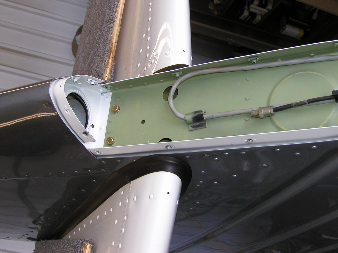

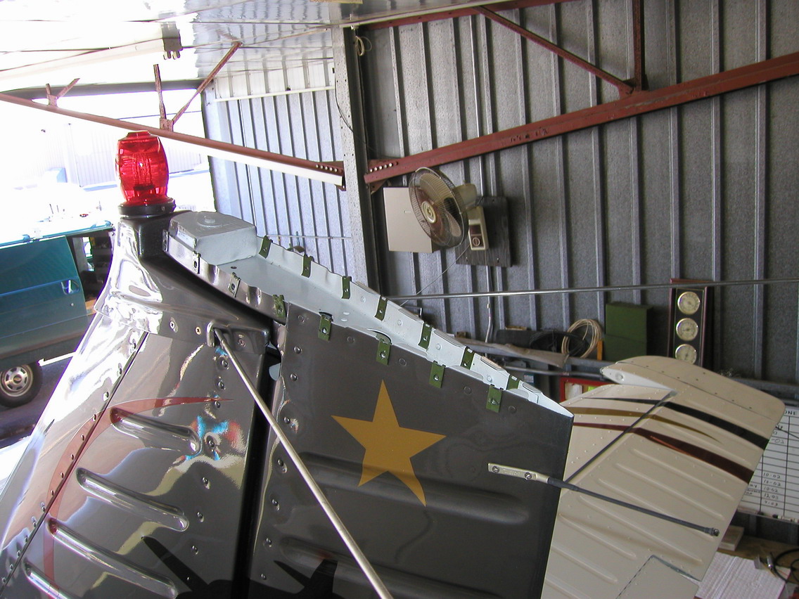

  • Rudder spar missing rivets - submitted by Ron Bishop
Apparently the factory may have missed some important rivets in the tail assembly on a very few planes. This write-up has good pictures and service information. Definitely worth checking at the next annual. Click here.
top

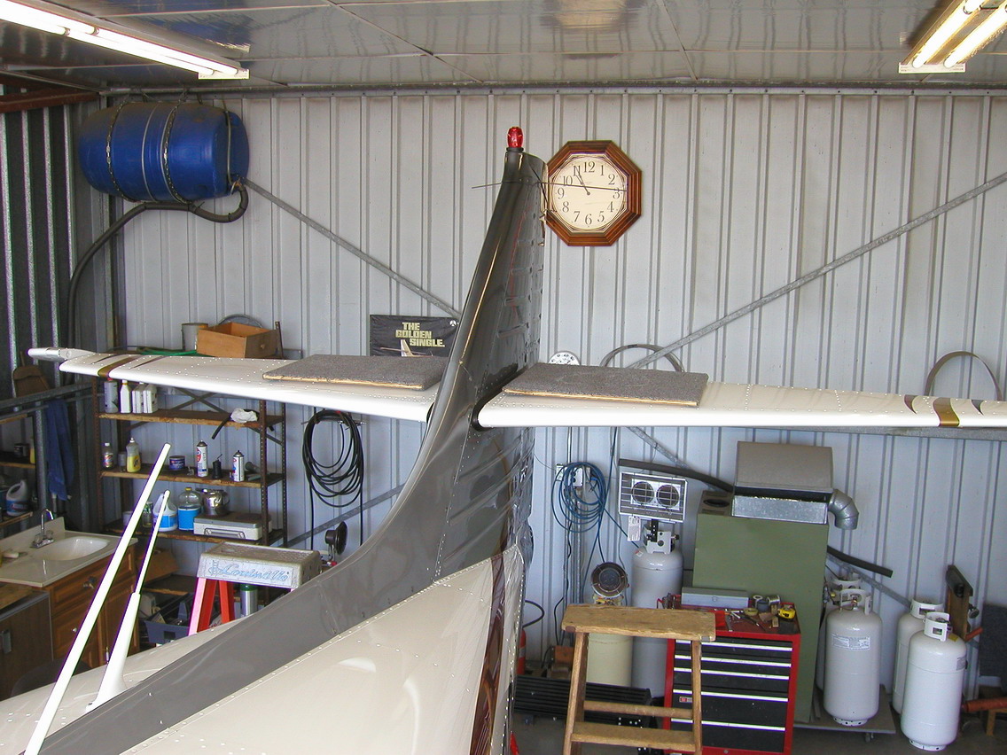

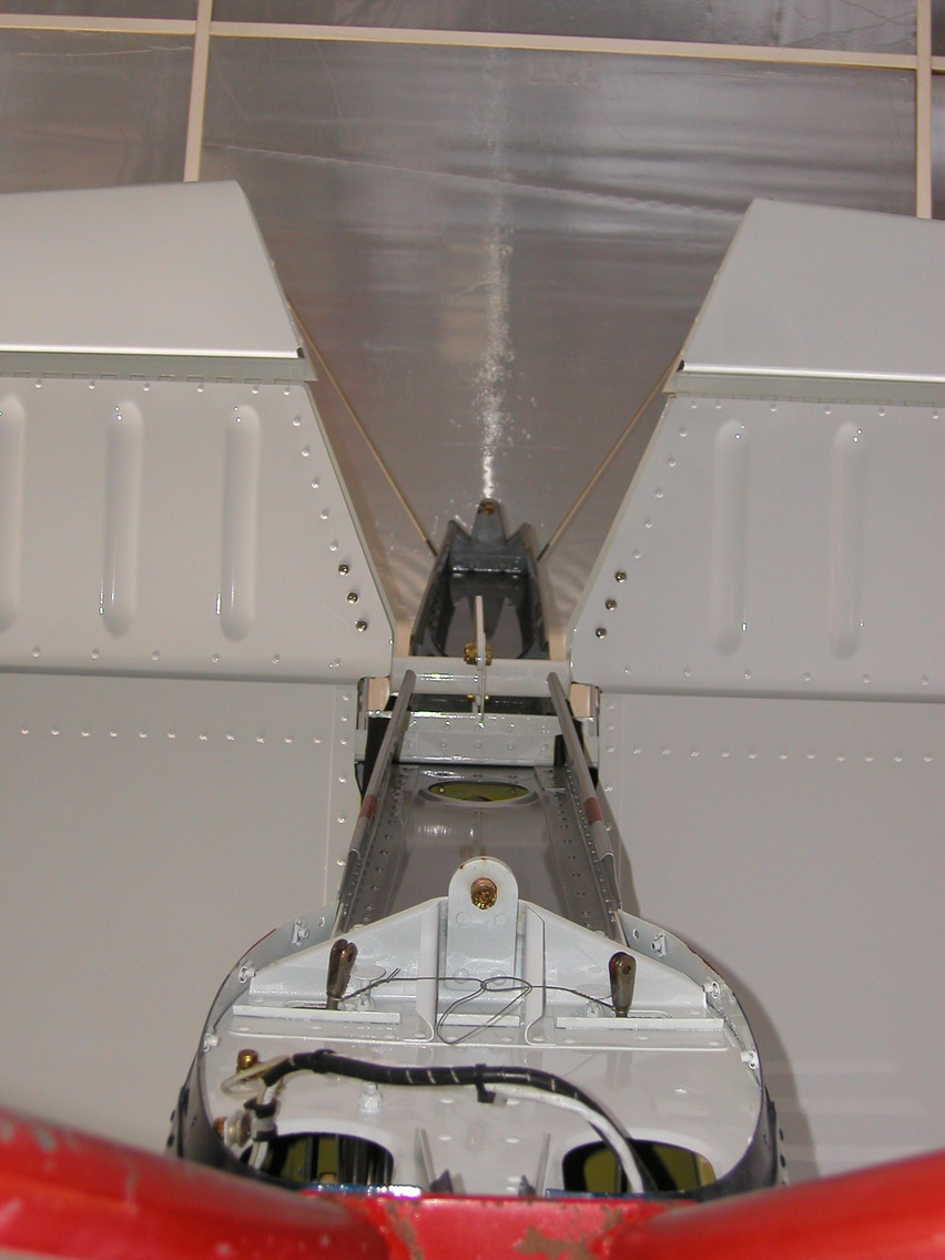

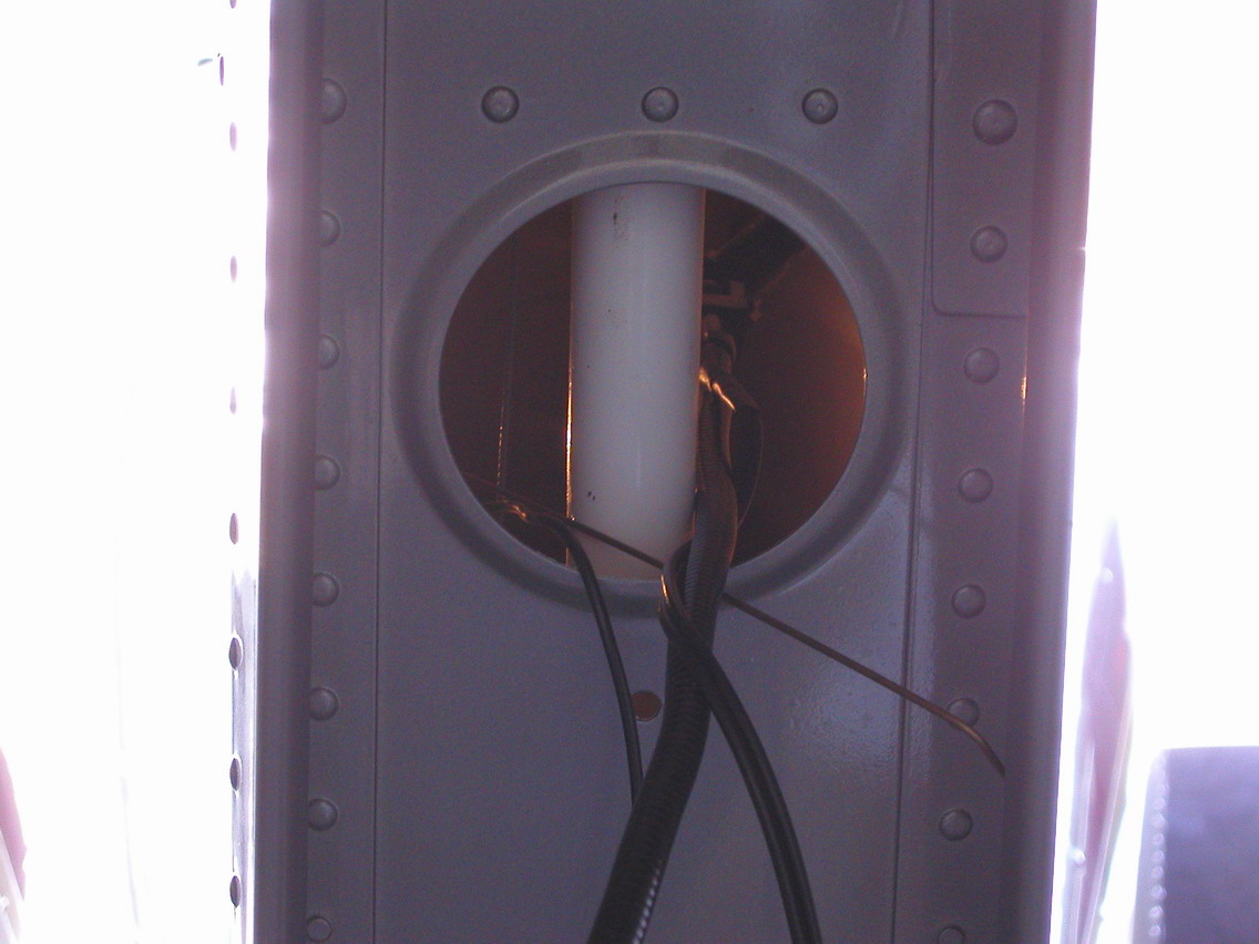

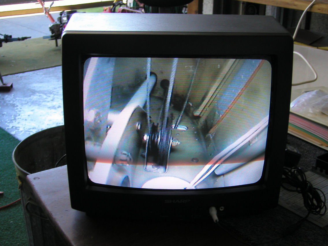

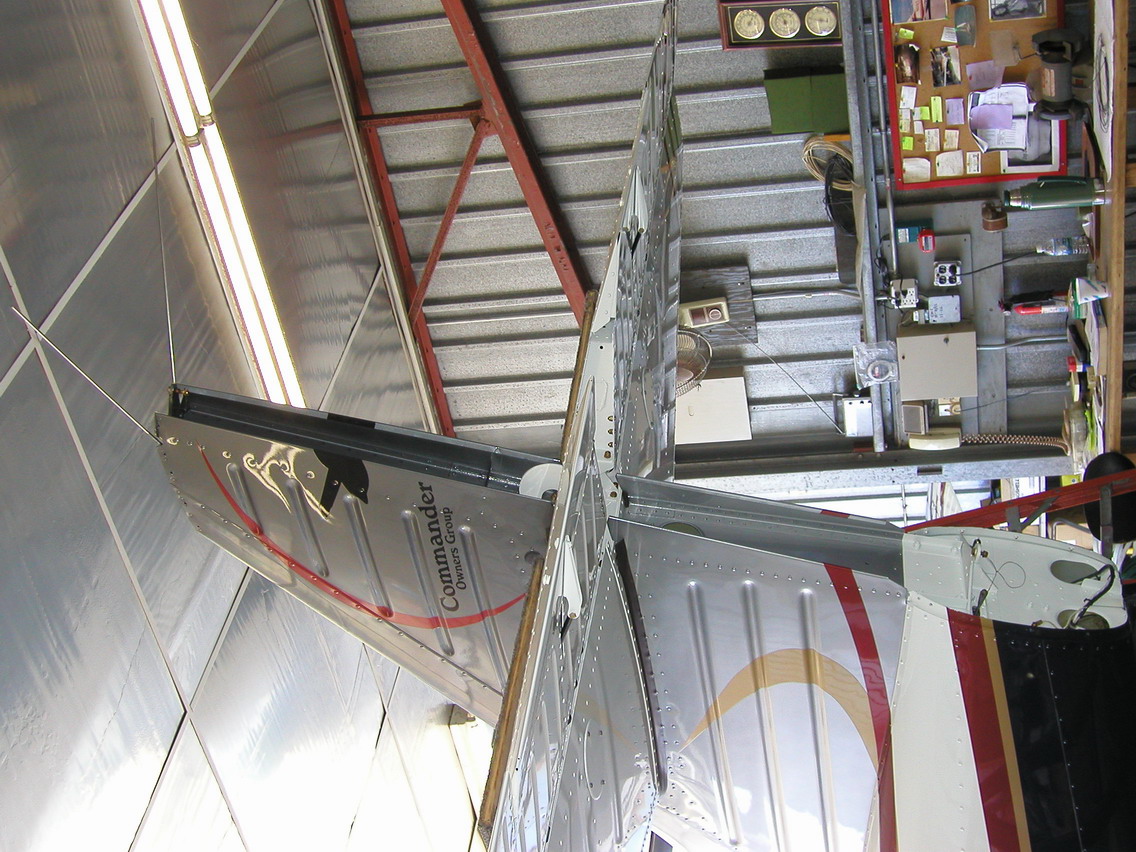

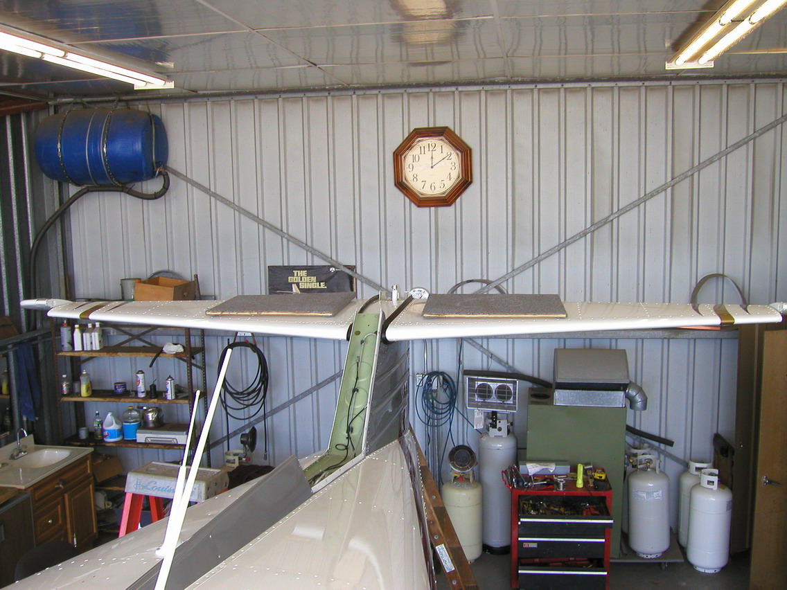

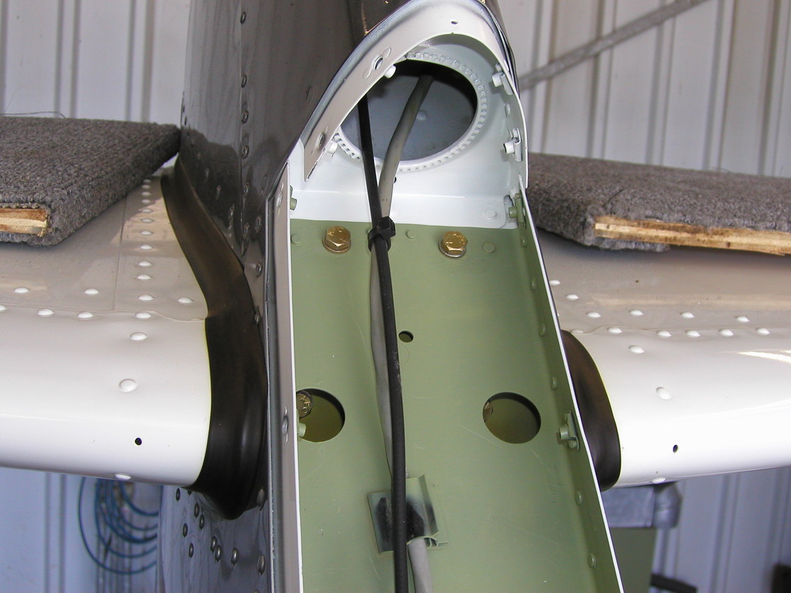

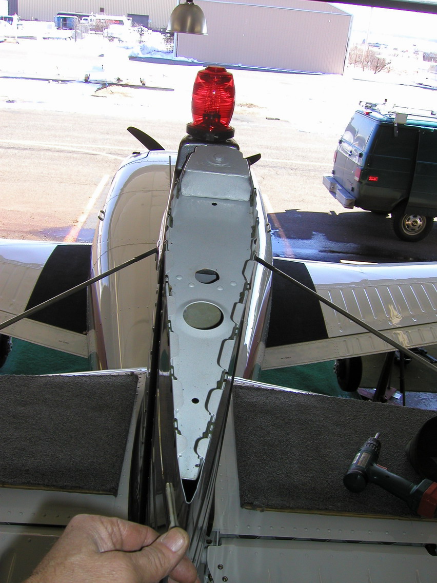

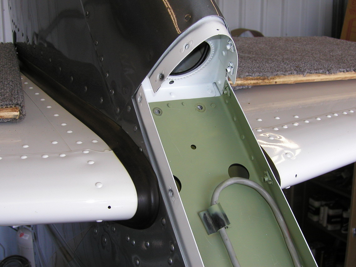

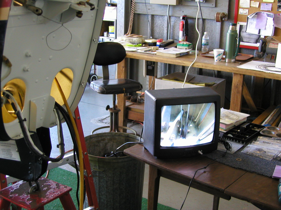

  • Tail tutorial: disassembly and internal pictures - submitted by Sven Faret

Check your logs to see when your main and gear solenoids/contactors were last replaced. These are not expensive (well under $20 each). If the main power contactor has been installed for more than 5 years, consider replacing it before it becomes unreliable. Cheap PM. Gear contactors don't get as much use and have longer useful lives, but if they are still OEM from original manufacture, it's definitely time to replace for PM purposes. If you have original clamping diodes installed across the contactor coils, these cost pennies to replace and be certain to install them w/ the same polarity as the old ones. These do not need frequent replacement. If they are missing, go get some and make it right straight away. Info in hangar section for all these parts.
